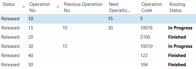

      We have ran into this as well.  Our issue stems from over output as well and correcting the over output on the wrong operation code of the production order.  On production orders, output is placed into inventory if the next operation code is blank.  Here is what we discovered:
      1. Supervisors were adding lines to and removing lines from production order routers.  When they did this, NAV renumbers the previous operation code and next operation code.  If an operation is marked finished, the previous operation code and next operation code are left blank and the remaining operation codes are filled in.
      2. If the item returned to an operation code with a blank next operation code and the worker enters output, this is placed in inventory.
      3. When we saw this, we would enter a negative quantity in our last operation to correct output.  However, this caused valuation issues because the output was not removed from the same operation that placed it into stock.
      I am working to figure out how to correct WIP and COGS.  If anyone has ideas, I would love to hear them.
      Now, we make sure to fill in the previous and next operation code if we make changes and if we have over output we investigate to find the operation code the output came from.
