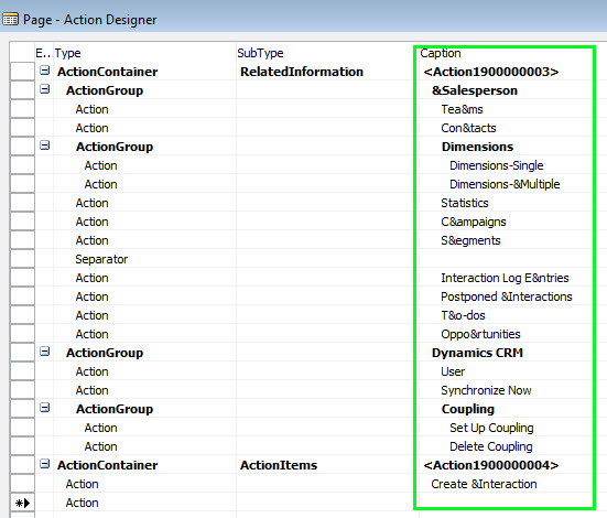

      Hello!Ā  I would like to know why ampersands are used in the Captions of page actions. For example, the attached screenshot of the Salespeople/Purchasers page has Tea&ms and Con&tacts as the captions. What is the purpose of the ampersands. I can’t find the answer anywhere and hope someone knows.
      The Action Captions contain ampersands in them.
      Thank you!
      Vivian
    • Rick Tweedle
      November 6, 2019 at 2:12 PM
      the are used for shortcut keys..
      i.e. &File Ā Ā  so you can press ALT +F to access the File menu
      So segments (S&egements) you can access the dimensions menu and then press eĀ  instead of click with the mouse
