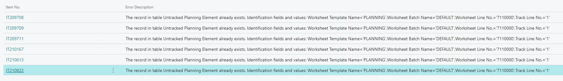

      Good morning everyone!
      When running the planning worksheet we are often running into this error message. Can anyone elaborate on how to rectify this?
      Caitlin Reardigan
      Canalta Controls Ltd
      Red Deer AB
    • Kris Ruyeras
      June 9, 2022 at 1:18 PM
      If you look at your Planning Worksheet, navigate to the corresponding line, in your case, it’s Line 7110000. From the factbox, you should see the Untracked Planning Elements for that line and make your corrections. Start from there.
