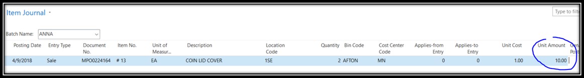

      The item journal does have the field unit amount, I know when I post an entry type of sale with a value in unit amount;

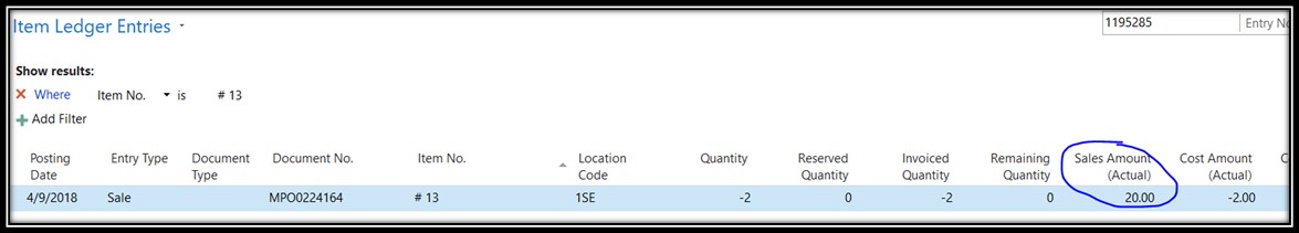

      The resulting item ledger entry looks like this;
      Item Analysis View Entry of Analysis Areas Sales and Inventory do capture Sales Amounts for this type of entry, $20 in this case.
      However, the sales amount does not impact the general ledger, the cost side does hit cost of sales / inventory.
      I’ve not personally posted item journals of entry type sale with a unit amount <> 0.  I guess it gives you flexibility to post sale of an item that may have been missed on a shipment, for whatever reason, without having to write off item quantities (negative adjustment or physical count)?
