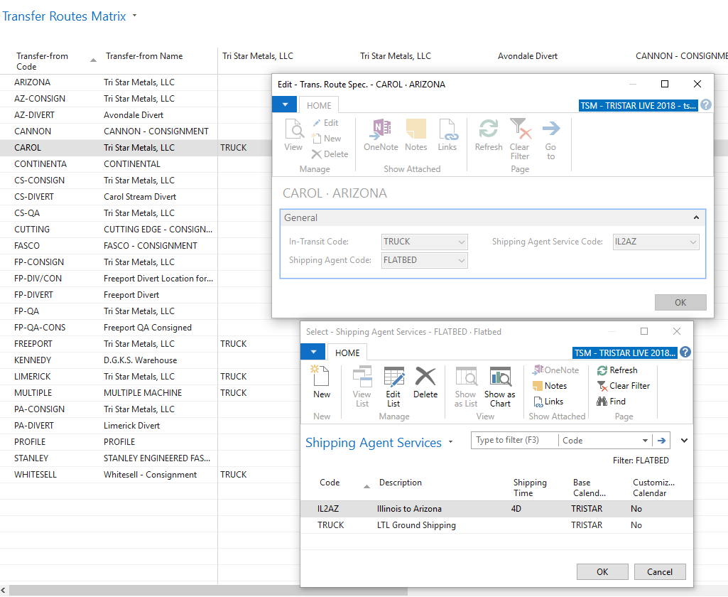

    • Gregory Alford
      June 17, 2019 at 10:55 AM
      1.Ā Ā Ā Ā Ā Ā  Navigate to Transfer Route Setup: TSM/Departments/Inventory/Setup/Setup – Inventory.
      2.Ā Ā Ā Ā Ā Ā  Click on “Transfer Routes”.
      3.Ā Ā Ā Ā Ā Ā  Click on “Show Matrix” in the ribbon.
      4.Ā Ā Ā Ā Ā Ā  Click on the Transfer Route.
      5.Ā Ā Ā Ā Ā Ā  There is field for the “Shipping Agent Service Code”. Use the pull down and click on “Advanced”.
      6.Ā Ā Ā Ā Ā Ā  Edit or add a Shipping Agent Service. Then update the “Shipping Time”. For example, from our Illinois facilities to our Arizona facility we have “4D” entered.
      7.Ā Ā Ā Ā Ā Ā  Close all the windows and your system should now correctly calculate transfer time.
      Screen Shots of Transfer Time Setup
      Gregory Alford
      Director of Technical Resources
      Tri Star Metals LLC
      Carol Stream IL
