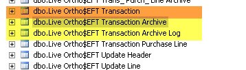

      The transaction year also tells a story.  We have quite a few EFT Transactions stored here going back to the beginning.  I also found EFT Transaction Archive and EFT Transaction Archive Log tables are empty.  Why? It’s clear they were created for a reason, so why aren’t we archiving old EFT Transaction data?  I believe we can improve the SQL performance on this table dramatically if we simply archive some of the old EFT Transactions.

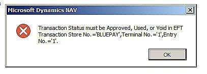

      wOiNtLTQaCB1vuGqijQf_11.jpgvS6QER8LSieVPoy0S7mg_10.jpgThank you for pointing that feature out! I attempted to archive anything over a year old (in our development database) And I received this error message.  Look at how many transaction statuses we have that are not approved, used, or void.  Is there a way to void these? It’s worth noting that we only used BLUEPAY for ACH transactions.  I could change their status programmatically with a script, but I want to avoid that unless a last resort.

    • Paul Turner
      March 15, 2017 at 7:54 AM
      If you don’t need to keep an archived copy of those transactions, you can simply delete those.
      Go to the “EFT Gateway Account Status” form/page.  The New transactions show under the Unsubmitted Transaction Count and you can select more than one record from that list to delete.  Declined, Duplicate, Failed, Error, and Referred transactions show under the Unapproved Transaction Count and also can be mass-deleted from there.  Queued transactions show under Queued Transaction Count but I am not sure if you can delete those if a related document still exists.

    • Jason Hall
      March 24, 2017 at 2:03 PM
      Jason, Paul, and Crystal, thank you for your replies and your recommendations. They all were very useful! This was my very first post on NAVUG and I’m really pleased with the support.  I marked Crystal’s as the best response but you all helped me get to the solution. I’ve actually taken a piece from all of you.  I ended up calling the Archive function from my own Code Unit and placing my own custom purge activity on the menu suite. I wasn’t able to do this until I got rid of the abandoned transactions in the system.  I even had to change the layout to the EFT Transaction Archive table.  It was out of synch with the record layout for the EFT Transaction table.  May have been a miss during the last NAV upgrade that was performed here.
