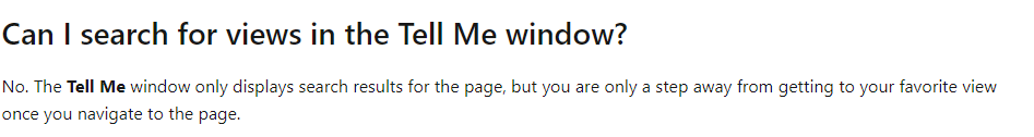

      If I saved and view in RTC, I was able to find it using Search. This doesn’t seem to work in the web client (BC2020 w1).
      Anyone know if there’s a way to do or just if it’s a limitation?

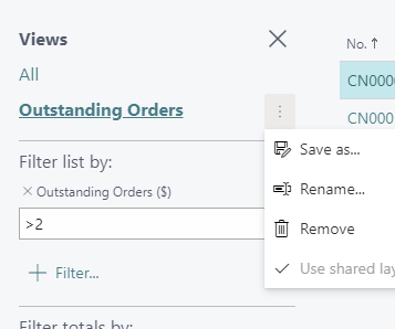

      This probably isn’t the answer you are looking for, but I save lists filtered by my saved views by bookmarking the URL in my browser.

      We did originally try that and it worked for the user who created the view, but didn’t work for other users.
      It’s actually a real pain in web client, as I have to go into customize pages (which most users will not have access to) and create that view for every Profile who needs it

      It looks like you can save views when filtering (Save and Personalize List Views), but it looks like being able to make the view searchable would be a customization according to Microsoft.

      September 3, 2020 at 8:42 AM
      Thanks David.Ā
      Reached same conclusion. Big loss in Web UI
