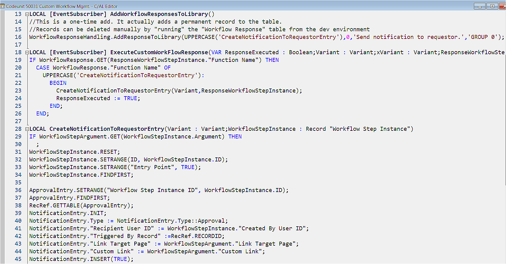

      I used the solutionĀ Ā ?provided here and it works great:

      Or you can add it to the response library to be able to reuse it as a response in any workflow on code unit 1521 (Workflow response handling) AddResponseToLibrary(CreateNotificationToRequestorEntryCode,0,CreateNotifOriginatorEntryTxt,’GROUP 0′) and then look for the “Created by User ID” of entry point CreateNotificationToRequestorEntry(Variant : Variant;WorkflowStepInstance : Record “Workflow Step Instance”) IF WorkflowStepArgument.GET(WorkflowStepInstance.Argument) THEN;WorkflowStepInstance.RESET;WorkflowStepInstance.SETRANGE(ID, WorkflowStepInstance.ID);WorkflowStepInstance.SETRANGE(“Entry Point”, TRUE);WorkflowStepInstance.FINDFIRST; ApprovalEntry.SETRANGE(“Workflow Step Instance ID”, WorkflowStepInstance.ID);ApprovalEntry.FINDFIRST;RecRef.GETTABLE(ApprovalEntry);NotificationEntry.INIT;NotificationEntry.Type := NotificationEntry.Type::Approval;NotificationEntry.”Recipient User ID” := WorkflowStepInstance.”Created By User ID”;NotificationEntry.”Triggered By Record” :=RecRef.RECORDID;NotificationEntry.”Link Target Page” := WorkflowStepArgument.”Link Target Page”;NotificationEntry.”Custom Link” := WorkflowStepArgument.”Custom Link”;NotificationEntry.INSERT(TRUE); ——————————JUAN CRISPINChewy.comPompano Beach FL

      Here’s what I did…(based on Juan’s guidance above)
      Sample code for Notification to Requestor
