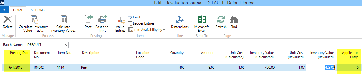

      Did you select the applies to entry of the receipt you wanted to revalue when you did your revaluation? This is required for NAV to update the costs on items that have been sold and invoiced.

      In addition to Dave’s suggestion of using Item Charges, or you can use the Revaluation Journal.Ā  TheĀ Reval Journal has two options when selectingĀ the date on whichĀ your revaluation is done. You can Ā select the original receipt entry of the item ( Applies-to Entry field)Ā which will use that date in the journal or you can use the Calculation step which willĀ use today’s date and only revalue the current remaining quantity.
      If you select the Original positive entry (Purchase, Output, etc.) it will also post revised cost values for anything sold or consumed since the original date however, the entry will be posted on that original receipt date.Ā  This means if that accounting period is not still open, you may only want to adjust the cost for the remaining quantity.

      Since you want to cost of items that have already been sold the invoices posted to be adjusted, Crystal’s suggestion of using the revaluation journal is the way to go.
      I can confirm that when you select the applies to entry of the receipt for the items you want to revalue, after you post the revaluation NAV will change the cost on the inventory still in stock and also that has been sold.
      You can look at the posted invoice statistics after doing the reval to confirm:
      Or in the Value Entries Table:
