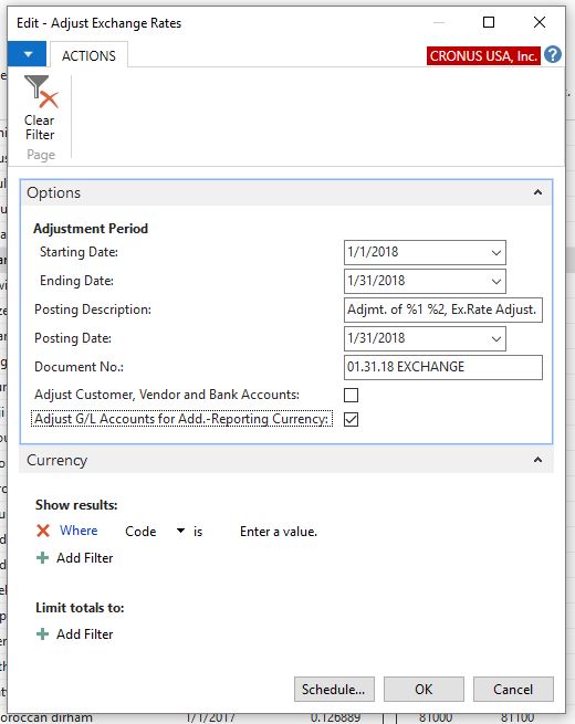

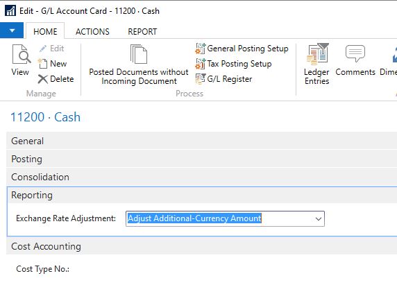

      I’ll expand on what mentioned with reporting. All transactions using the ARC will post at the exchange rate in the table. This typically means that BS entries are going to be posted at the daily rate and not the month end rate, which is required for US GAAP. If the local GAAP requirements are similar, you will want to update the ?Relational Adjmnt Exch Rate Amt for the last day of the period to the Month End rate and Run the Adjust Exchange Rate functionality. The accounts you want to update need to have the Reporting Exchange Rate Adjustment setup to Adjust Additional-Currency Amount.

      Thank you for your reply. Based on yours and others replies, it appears as if we have ZAR as the additional reporting currency and record transactions using KES (Kenya Shillings), we will not be able to run standard financial reports from NAV that are based on the KES. Even with running the Adjust Exchange Rate functionality, the adjustment is based on ZAR. We would need customized reports that would provideĀ financial statements inĀ KES.
