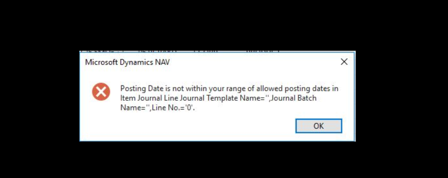

      When posting a Dynamics NAV consumption journal I occasionally get the unexpected error  “Posting Date is not within the allowed date range”.  Journal batch = ‘blank’ and line = ‘0000’.
      Automatic Cost Posting = TRUE
      Adjust Cost = Always
      The only work around is to set the User date range to Allow Posting From = ‘blank’
      Has anyone else experienced this error?  Do you know of a Hotfix?
       Bob

      I’m not sure if this directly relates to your situation, but I have had this exact error message if the G/L Setup posting range is larger than the User Setup posting range and Adjust Cost is on.
      Example:
      G/L Setup posting range = 3/1/17 to 4/30/17
      User Setup posting range = 4/1/17 to 4/30/17
      User tries to post some inventory transaction: “Posting Date is not within your range of allowed posting dates in Item Journal line Journal Template Name=”,Journal Batch Name=”,Line No.=’0′
      The only ways I have found around this are
      • Move User Setup posting range back
      • Move G/L Setup posting range forward
      • Turn off Adjust Cost

      Sorry for not posting sooner. I was out with family on school spring break.Ā  Everyone has hit on the key challenges here.Ā  The Allow Posting From and To Date in General Ledger Setup must be within all of the user date ranges – i.e. it must be a narrower range than the usersĀ – if Automatic Cost Adjustment is set to anything other than Never.Ā  If Auto Cost Adjustment is Never and Adjust Cost Item Entries batch job is run, then the date range for the user running the process will need to be broader than the General Ledger Setup.
      Typically, the biggest challenge comes from a couple of scenarios that I see most often –
      1 – Post a Purchase Invoice at a different Direct Cost after Receipt was posted in an earlier period. The Purchase Receipt quantity has been applied against Sales/Consumption/Negative Adj.Ā  Automatic Cost Adjustment will result in Adjust Cost processing adjusting the negative entries based on the change in Purchase Cost on the Invoice Posting Date. However, the User Posting Date Range, if it is narrower than General Posting Setup Date Range, will cause theĀ error because the User doesn’t have the open period available in their date range where cost adjustments are generated.
      2 – Much more subtle and a bit more challenging. A user is posting a Sales/Consumption/Neg. Adj. that closes a FIFO/LIFOĀ positive quantityĀ  layer.Ā  A rounding residual balance of pennies is left on the layer, so cost adjustment will push a Rounding Value Entry back to the Purchase (or other Positive Qty. Layer).Ā  If the General Ledger Setup Posting Date range is broader than the user posting the entry with Automatic Cost Adjustment enabled, then you will see error like this.
      These are not meant to be all inclusive reasons, but these are two of the more common issues I see.
      The best practice is –Ā if Automatic Cost Adjustment in Inventory SetupĀ is enabled with a setting other than Never, then User Posting Date Ranges must be broader than the General Setup Posting Date Range.

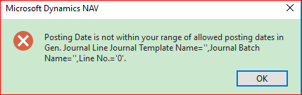

      Ian and Meenakshi are correct.Ā  You need to increase the range of the user running adjust cost to at least include the same range as the General Ledger Setup Allow Posting From and To range.
      Adjust Cost posts based on the original transaction so there could easily be a date older than you might expect.Ā  Adjust Cost has some code (Table 98 General Ledger Setup Function FirstAllowedPostingDate) that forces the earliest date that it can post based on the General Ledger Allow Posting From field.Ā  This way Adjust Cost is able to post entries that normally would fall into a closed period.Ā  The problem you are most likely experiencing is that it is allowable for your company but not for the specific user.Ā
      An example I ran into the other day was:
      General Ledger Setup 03/01/17 to 04/03/17
      User running Adjust Cost 03/31/17 to 04/30/17
      Error:
      So I fixed this by changing General Ledger Setup from 04/01/17 to 04/30/17 (now the User encompasses more than General Ledger Setup)
      Please note though that by changing the General Ledger Setup side of things there would have been an entry that would have posting before 03/31/17 that now is forced to a new date of 04/01/17 (see bold comment above).
