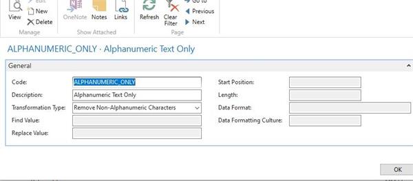

    • Justin Falconer
      September 10, 2019 at 11:17 AM
      We have it setup with a Transformation Rule called “ALPHANUMERIC_ONLY”
      Justin Falconer
      Tender Corporation
      Littleton NH
    • Ryan Porter
      September 10, 2019 at 12:06 PM
      Thanks to all for your help!
      For anyone in the future that might be searching for a solution to the same question I had, Justin’s recommendation to add a “Transformation Rule called ‘ALPHANUMERIC_ONLY’ ” worked for me.
