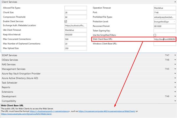

    • Saurav Dhyani
      September 8, 2020 at 4:06 AM
      Mark,
      As per Kyle comment, you need to set the web Client Base URL. Then Restart the Service Tier and try again.
      Attached is the image how to set Base URL – http://ServerName:8080/BC160/WebClient/
      Change Highlighted value as per your configuration.

    • Mark Anderson
      September 8, 2020 at 7:26 AM
      I did fix it last week by doing this. Forgot to update the thread.
