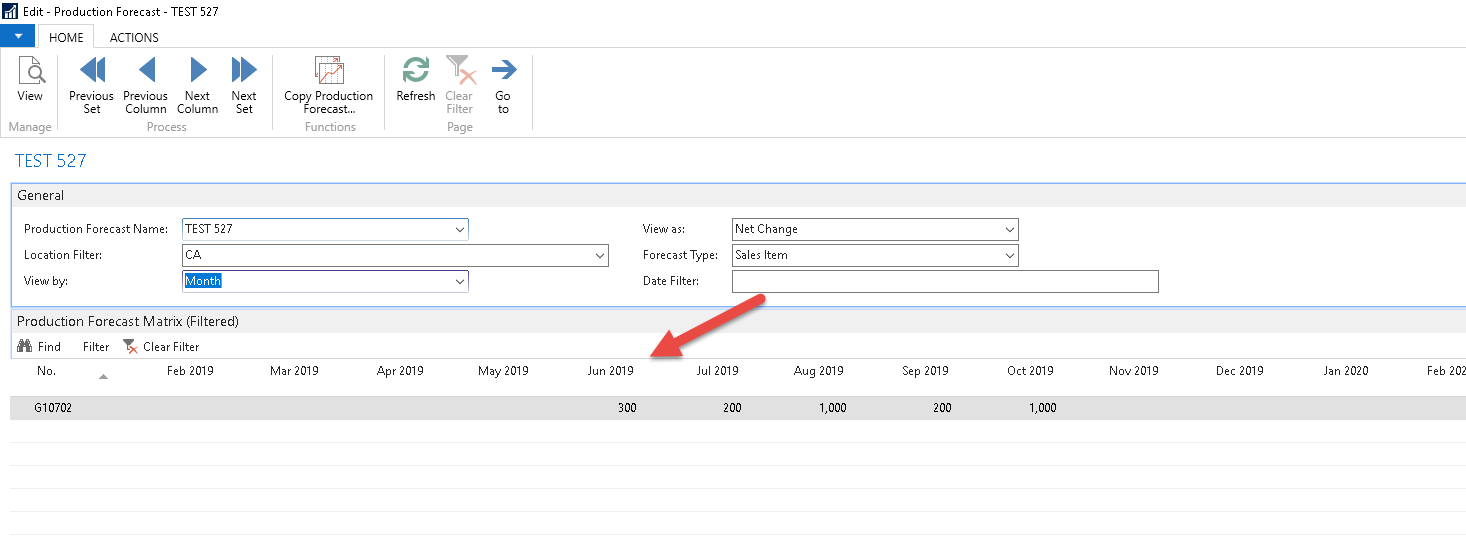

      Our forecast is based on previous years sales.Ā  Ie:Ā  Sales from June 2018 are used to plan for requirements in June 2019.Ā Ā
      Forecast

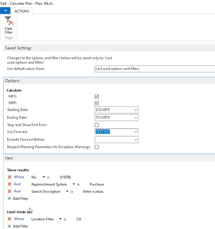

      When we calculate the plan, all of these settings work perfectly.
      Calculate Plan

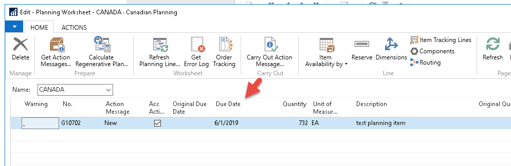

      Calculated Plan
      However, we need to product to be arrive, 60 days prior this.Ā  In this example we want to buffer the due date (expected receipt date on the PO)Ā  by 60 days –Ā  Due date April 2, 2019.Ā  The only date I was able to affect was the planned receipt date by entering 60 days in the safety lead time field.Ā  This affected the planned receipt date, but the date that is used by the system as the scheduled receipt date is the expected receipt date and not the planned receipt date.

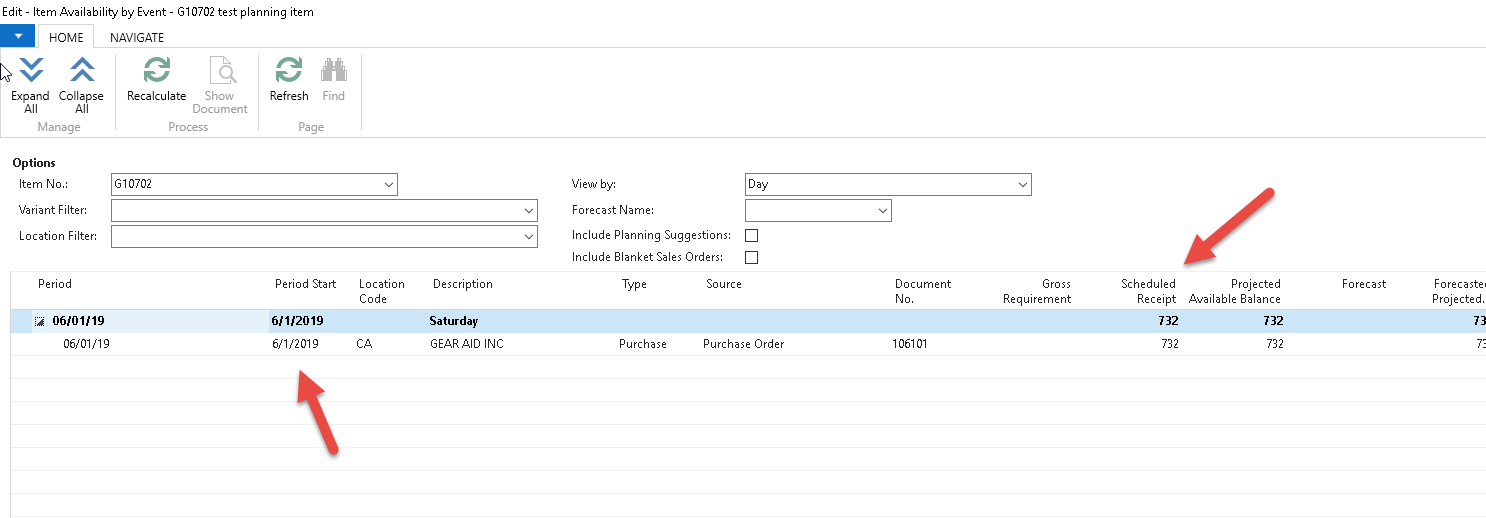

      Item availability
      Is this possible in standard Nav?Ā Ā ???

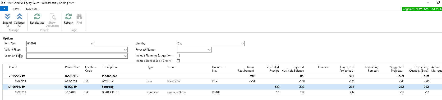

      However, Nav is still looking at the expected receipt date.Ā  If I enter demand for May, Nav is telling me that we won’t have stock, even though our planned receipt date is prior.Ā  Is there any way to get Nav to evaluate the planned receipt date rather than the expected?
      item avail
