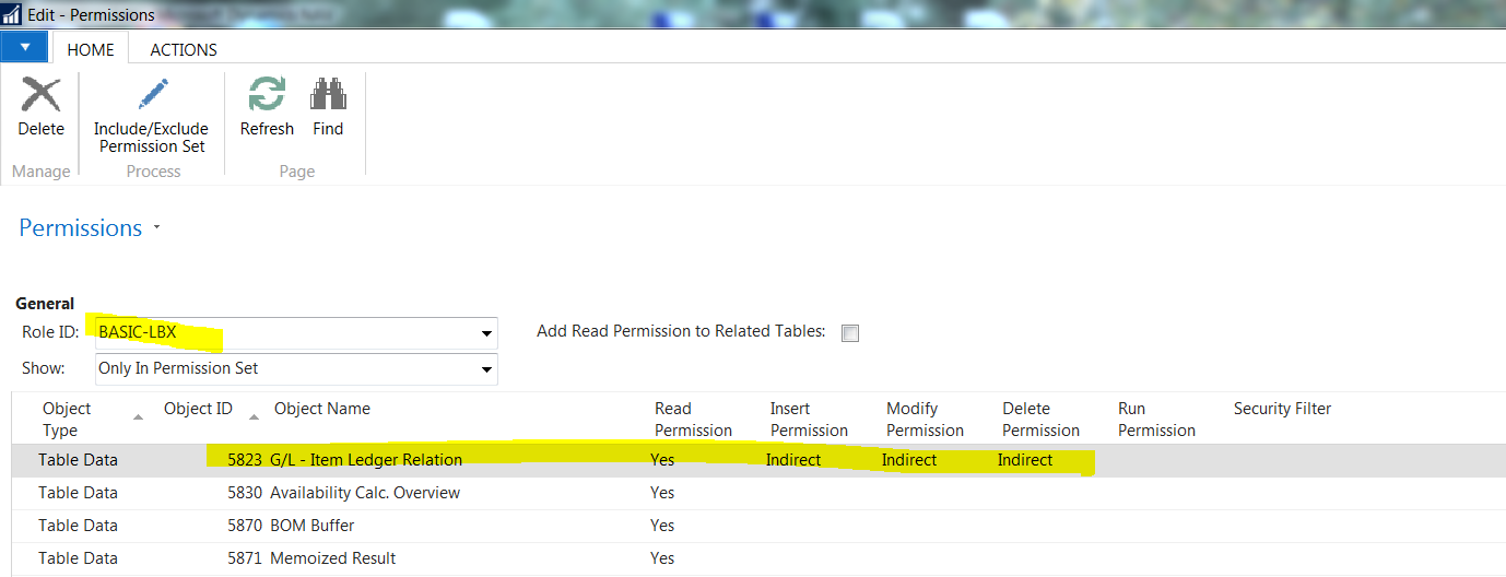

      We are on NAV 2016.Ā  We created a copy of BASIC where we added any additional permissions needed and custom object permissions.
      We added Indirect permissions to the G/L – Item Ledger Relation under our custom BASIC permission set. (For anyone posting transactions, this seemed to be necessary – thus we added to BASIC).Ā  Since it is indirect, no one will be able to do anything directly to that table.
      In other cases you may want to make a custom permission set if the permission error is more narrow or specificĀ to a certain area.Ā  In this case though – G/L – Item Ledger Relation will be needed in many areas.
