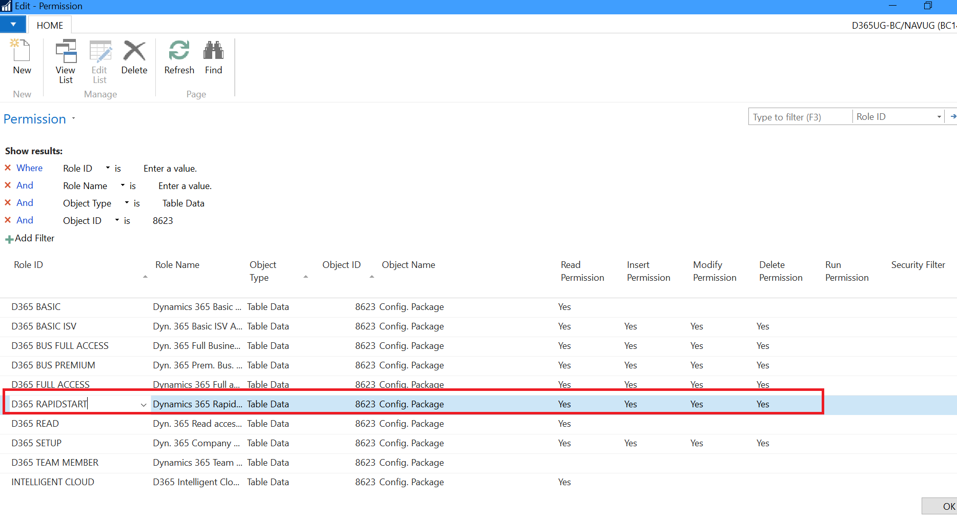

      November 9, 2020 at 7:18 PM
      Business Central has a permission set called “D365 RapidStart” that gives full permissions for table 8623.

      November 10, 2020 at 8:36 AM
      Hello Jeanmarie,
      You could create a permission set that does not allow INSERT access to TableData 8623.Ā  That would prevent importing into the Configuration Package.
      RapidStart will also not allow anyone to update tables if they don’t have INSERT or MODIFY permissions for that table.

      If, however you want to make a copy of your RAPIDSTART permission set and modify the copy, that should work too.Ā  I reviewed what you sent and your permission set matches the “RapidStart” permission set from Cronus (the standard Microsoft test database) except for one object.Ā  The Cronus database also includes a “D365 RapidStart” permission set which differs slightly – I’m not sure why.Ā  I also don’t know why the accounting table objects are included.Ā  Ā I have attached a comparison of your permission set with the two in Cronus.
