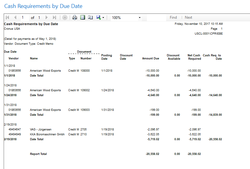

      4) Use the Cash Requirements by Due Date report (print detail) to see open Credit Memos. You can include all document types, or filter to Credit Memos.Ā
      Cash Requirements filtered to CM
