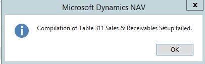

      xe4lDcaOTG6kOZJldI9c_OMA Compilation Error.JPG??We are using NAV 2015 with Object Manager Advanced for transport/deployment of object changes in NAV to the various environments.
      Does anyone know of a reason why, upon attempting to transport from the transport card, we continue to receive theĀ above error (object type and description vary based on what object is on the project being transported)? We have attempted to compile via the Development Environment application and receive no compilation errors there, so I’m not sure what is different when compiling via OMA through the RTC.

      This is odd.Ā  Go to Tools, Sync Schema For All Tables, Check Only.Ā  Did that work?
      Restart your Service Tier.
      What change caused this to start happening?

      ?Thanks for the response Jason. I synced schema for all tables, check only as you suggested. Result was “Operational”. We then restarted the service tier and tried to transport again. We’re still receiving the compilation error after all this. Honestly, I’m unsure as to what changed. We made no changes to OMA setup when this started occurring. I’m also unsure as to what would be different about compiling objects in the Development Environment Application versus OMA. I’ve searched the web to see if this is a known bug but found nothing. Additionally, as a test, in the Object Manager Setup window, I tried unchecking the Compile Objects setting in the Transports fast tab and transporting again but received the same error. Is it possible that permissions to the service could have been changed causing the compilation error?
