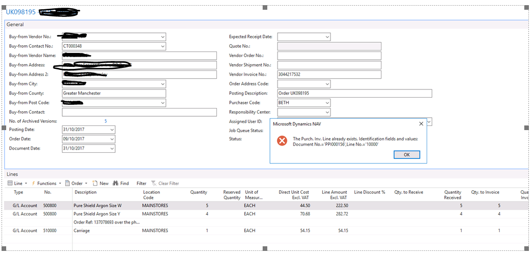

      Hi when trying to post a number of older purchase orders, receiving the following errors
      The number series has been changed and the system seems to be looking at the old number series, even though under the purchase & payables setup this has been changed to a new number series.Ā  The number shown has been used but it relates to the old number series.
      All new PO’s are posting with no issues
      Any ideas how to resolve?

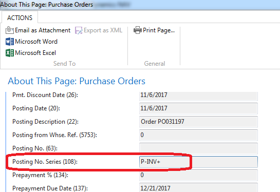

      ?Did you change the actual code used in Purchases and Payable Setup or did you change the numbering series prefix or range for the number series in use?

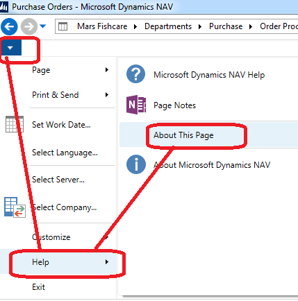

      It looks like once the document it created, it storesĀ the code for the number series to use when posting the purchase order.Ā  You can see this when youĀ  zoom to the Purchase Order recordĀ
      How to Zoom
      Ctrl-Alt-F1 (or Ctrl-WindowsKey-Alt-F1)Ā
      Expand Table Fields tab
      -or–
      ApplicationĀ  Menu button
      Help
      About this page

      One place to look is the Purchase Header table and look at the line for the PO involved.Ā  There is a field called “Posting No.” which may already be populated with an invoice number.Ā  We ran into that at one time where when attempting to post the invoice, it grabs a number and assigns it to the PO.Ā  It can then cause conflicts if the number is already used.Ā  Not sure how it happens.Ā  We found that if you clear that field on the PO and attempt to post again it should work.

      Change the PostingĀ No. to the next number in your new No. series in the PurchaseĀ Header table for that PO and the PO will post successfully. It’s still trying to post using the old no. and that series has been deactivated, hence the system is giving you errors.

      Thanks everyone for your help, exposed the posting no on the PO and removed and posted fine
