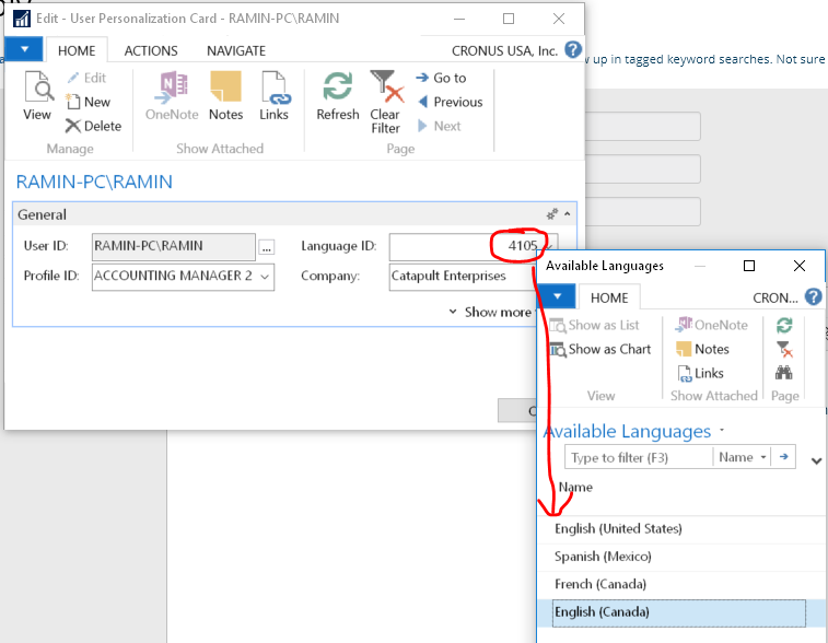

      Hey Samuel,
      Yeah, unless explicitly stated otherwise, dates conform to the regional settings. Have you tried setting the Language ID on the User Personalization to the desired date culture, to see if that does the trick for you:

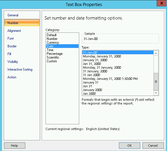

      ?Franz, yes I guess that could work, did you use a “d” date format in the report? Or only a string without format?
      There is a field for localization on SSRS reports, thatĀ NAV could be using instead.
      That would make the “d” and “n” formats use that region’s settings without having to hardcode anything.
      I’m not sure what control over the report parameters you have (new to NAV). If this is possible, that would be a better solution, and it is what Dynamics AX did.
      Here’s the field I am talking about:

    • Samuel Champoux
      February 5, 2018 at 8:35 AM
      ?Yes, the field Language on the report has an effect on dates. It’s the locale of the report, and that’s why right now it uses the users’ locale.
      Set it to fr-ca, and you’ll have dates with yyyy-mm-dd format, whatever the locale of the user is.
      The “d” I was referring to is the normal date format, it will use the date format of the report language. If you hardcode a date format, then it won’t use the report’s locale to determine the format.
      From this, I think if I add the customer’s language to a parameter and set it to the language parameter it should work like I want it to.
