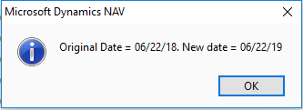

      I mocked this up in a processing report with a message to display the new calculated date:
      EDIT – NAV Assumes you are adding the date in my code above. If you need to subtract from a date, please see the other example posted at the same time I was replying.

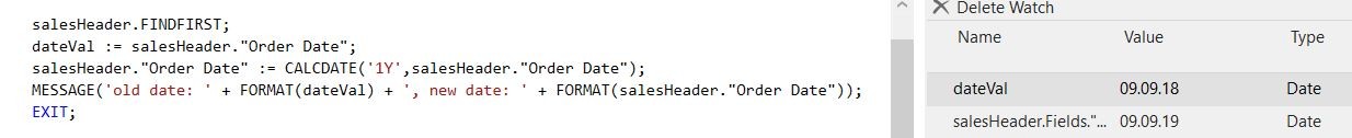

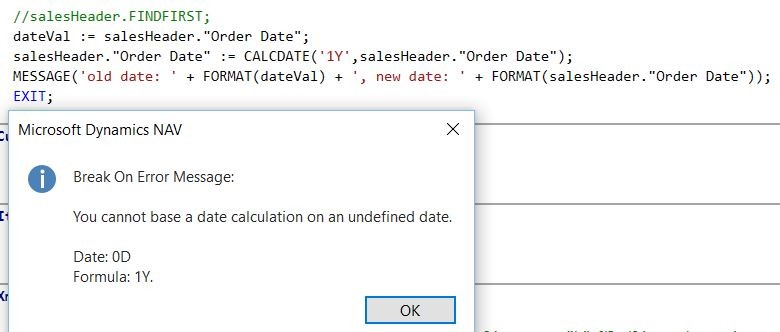

      developed some sample using sales header, field order date.
      as you can see, some error. why? the record was not loaded, so order date is 0D.
      when loading a record we get … see values in infobox right (debugger)
