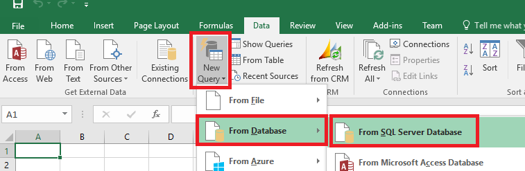

      You can then use Excel and connect to a Database to run this or any query safely and retrieve the results: From the network where the SQL Database lives, open Excel and choose New Query=>From Database=>From SQL Server Database.
      (Or you can choose ‘From Other Sources’ depending on what you need):
      Excel New Query

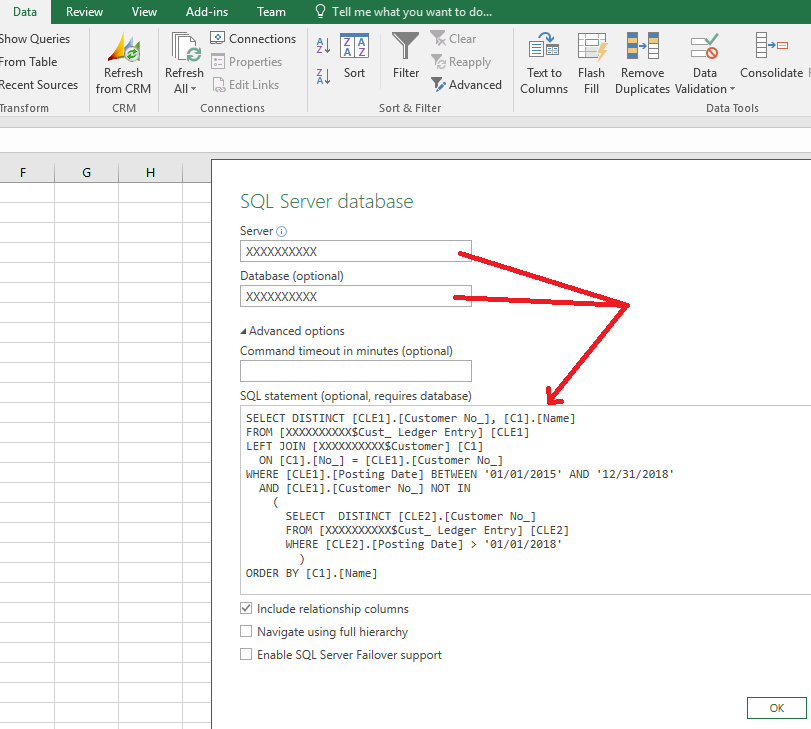

      Then enter in your written SQL query, and the serverĀ details,Ā to fetch such results. Read-only data access is all that is needed.
      Example Only:
      SQL Server Database Settings
      Note: You have to update the query where I put the X’s,Ā to suit your environment.
      Ā  – Server: is going to be the SQL Server name
      Ā  – Database: is going to be the Database name
      Ā  – Inside the query language: you have to replace the XXXXXX with the company-name-prefix that appears on all data tables in NAV.
