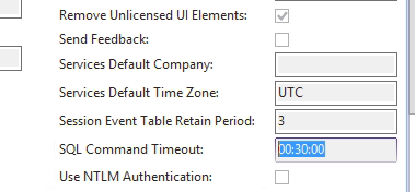

    • Ian Ray
      July 24, 2017 at 5:31 PM
      The timeout can be set in NAV Administration
      This is normally only extended for schema synchronization on upgrades, but a little more time may help with your particular issue.
