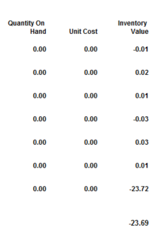

      We use average costing and I completely understand why we are getting 0 Quantity Items with a value (either positive or negative) in some of our warehouses.Ā  Cost either gets left behind or transferred in excess of the original cost of the item. No problem there.
      Question for you all is:Ā  Is there a workaround to move the negative or positive value associated with the 0 inventory into the warehouse that has inventory? We’re talking $20, not a big value.Ā Ā
      I have tried in the test environment toĀ
      1)Ā  Item Journal- remove all inventory from all warehouses and then receive back into the warehouse it belongs in (still maintains the value in theĀ  0 qty warehouse)
      2) Item Journal- Add a quantity to the 0 quantity warehouse and then remove it (still maintains the value in the 0 qty warehouse)
      3) Revaluation won’t work since that simply applies a new value to all current inventory
      4) Selling the product- still maintains the values
      I understand that the value is moving at the average cost, even if I change the cost in the item journal it does not affect the movement of inventory at the average.

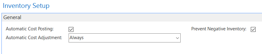

      Thanks for the advice! We have Automatic Cost Adjustment set up in our Inventory Setup so I don’t think running Adjust Cost does anything new?Ā

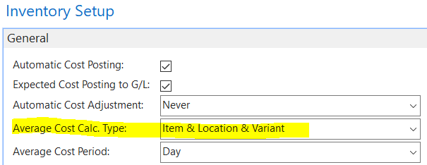

      In Inventory Setup, there is a setting for Average cost Calc Type.Ā  What is your selection?Ā  We had this issue and discovered our setting was by item, which means average costing did not take into account cost by location.Ā  We updated our Average cost Calc Type to by Item & Location & Variant and most of our issues cleared up.Ā  Please note, the process to make the change involved a lot of testing and processing time.
      Inventory Setup
      Let me know if you have any questions.

      Thanks Kristina Frank- we actually do want inventory to average across all locations.Ā  We have it set to Item for that reason.Ā  I’m just looking for an easy way to get value out of a location we are no longer using.Ā  It is messing up the reports for the bank. Ā
