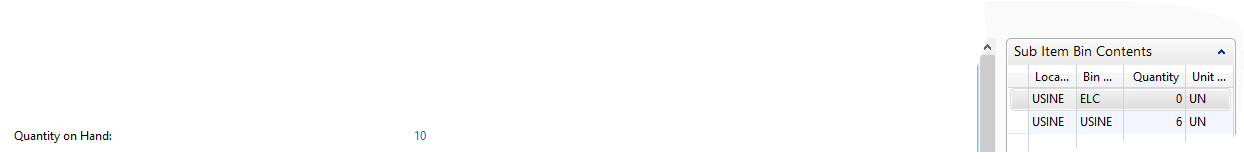

      Still a little new to NAV, I was wondering how we could have this :
      Where are the missing 4?

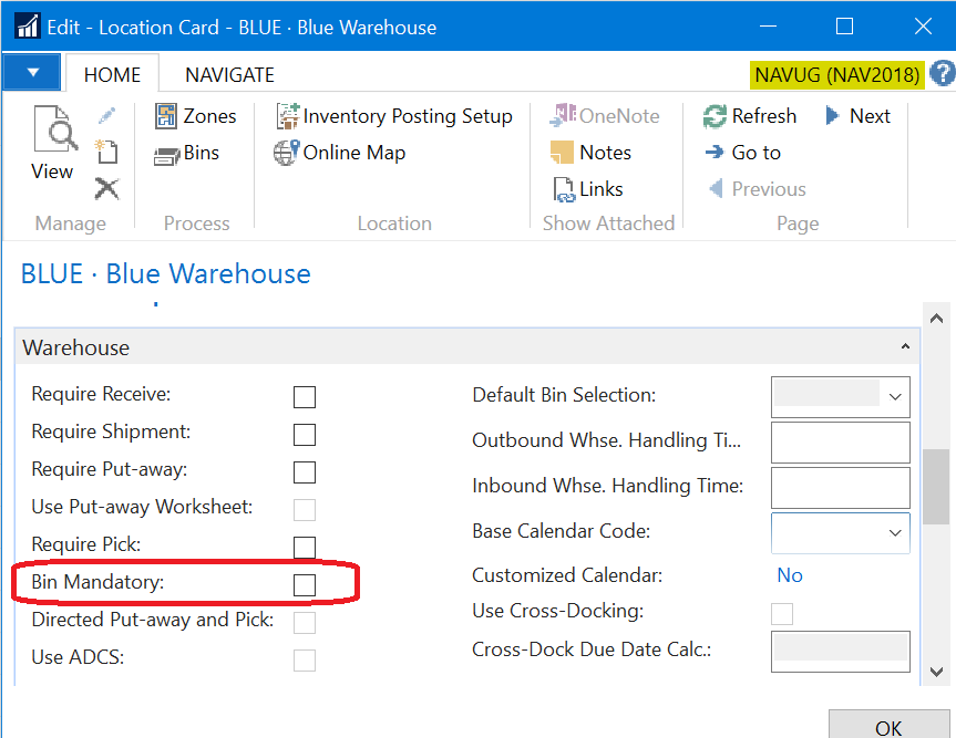

      ?Locations can only use bins if the Bin Mandatory box is checked on the Location Card.
      Location Card

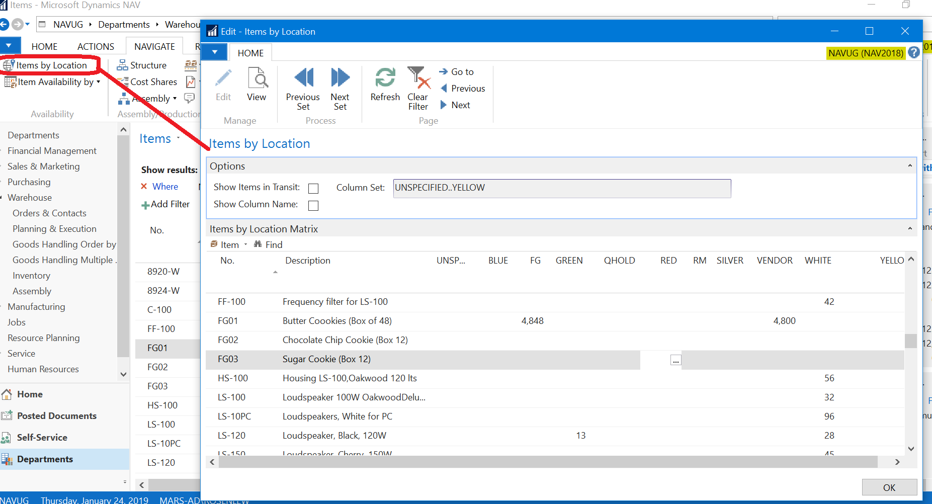

      To see inventory by (Warehouse) Location, go to the Item List or Item Card and Navigate to Items By Location:
      Items by Location

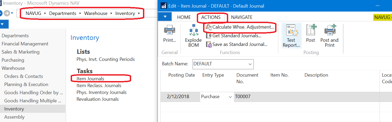

      My guess is that someone has already registered Warehouse Item Journal but forgot about Item Journal.
      What you can do is to check Bin Contetns once again. On the bottom of the page,there should be a flowfield created: Qty. on Adjustment Bin. If not available there – export Warehouse Entries to Excel, create pivot table and check on which bin qty is positive or run Calculate Whse. Adjustment (Item Journal Page) for Bin Mandatory Locations and check whether something is in Adjustment Bin

      ?Whenever there is a registered entry on the Warehouse Item Journal, it must be followed up with a Item Journal posting using Actions > Calculate Whse Adjustments to popuate the Item Journal.
