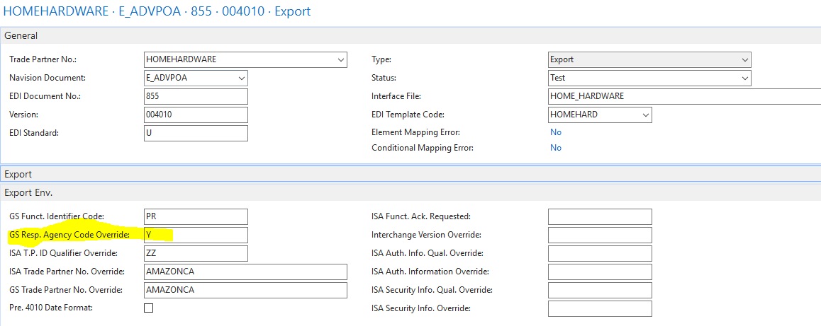

      I’m trying to identify if I have missed something in the setup of our Lanham EDI Trade partner or if we have some other issue.
      We have a new EDI trade partner that is requiring a GS07 element to be ‘T’ instead of ‘X’.
      On each of the export documents, I have the GS Resp. Agency Code Override set as ‘T’ in the Export Env. section.Ā  However, when I export the document, it still is specifying an X in the GS07.
      Any ideas?

      What version of Lanham EDI are you on?
      I just tried it on ours (EDI SE60.12) and it worked fine.
      GS07
      GS*PR*TENDERCANADAT*AMAZONCA*20180314*1654*200000006*Y*004010~

      We’re on 50.32 for the Invoice Export.Ā  Must be in the version.Ā  I’m glad to know I was going the right direction.
      In more research, It appears as though at some point we brought in a custom field to make the functionality work.Ā  So, luckily, I have found how to make it work in our version, and even better, your insight is telling me I don’t need that customization when we upgrade!
