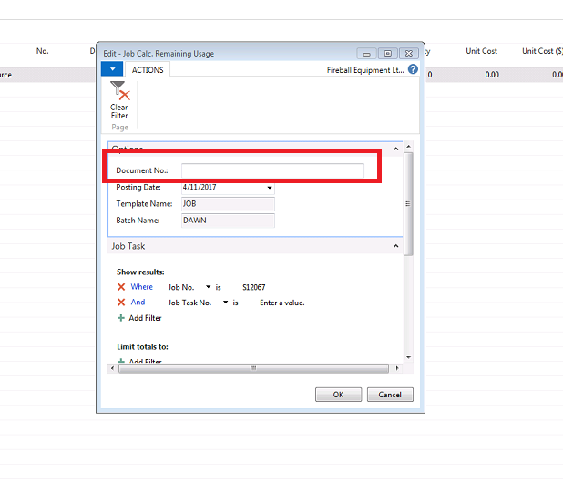

      Hey Guys,
      We are currently on NAV 2016 CU6 and have one user who has a job journal batch that when usage is calculated the document number does not auto-populate like every other batch.
      Each batch we have uses the same No. Series, but for some reason only one user is experiencing this problem.
      Anyone have any idea why this may not being set?
      Batches don’t have many setting and we’ve already tried clearing personalization’s with no avail.
      Thank you.

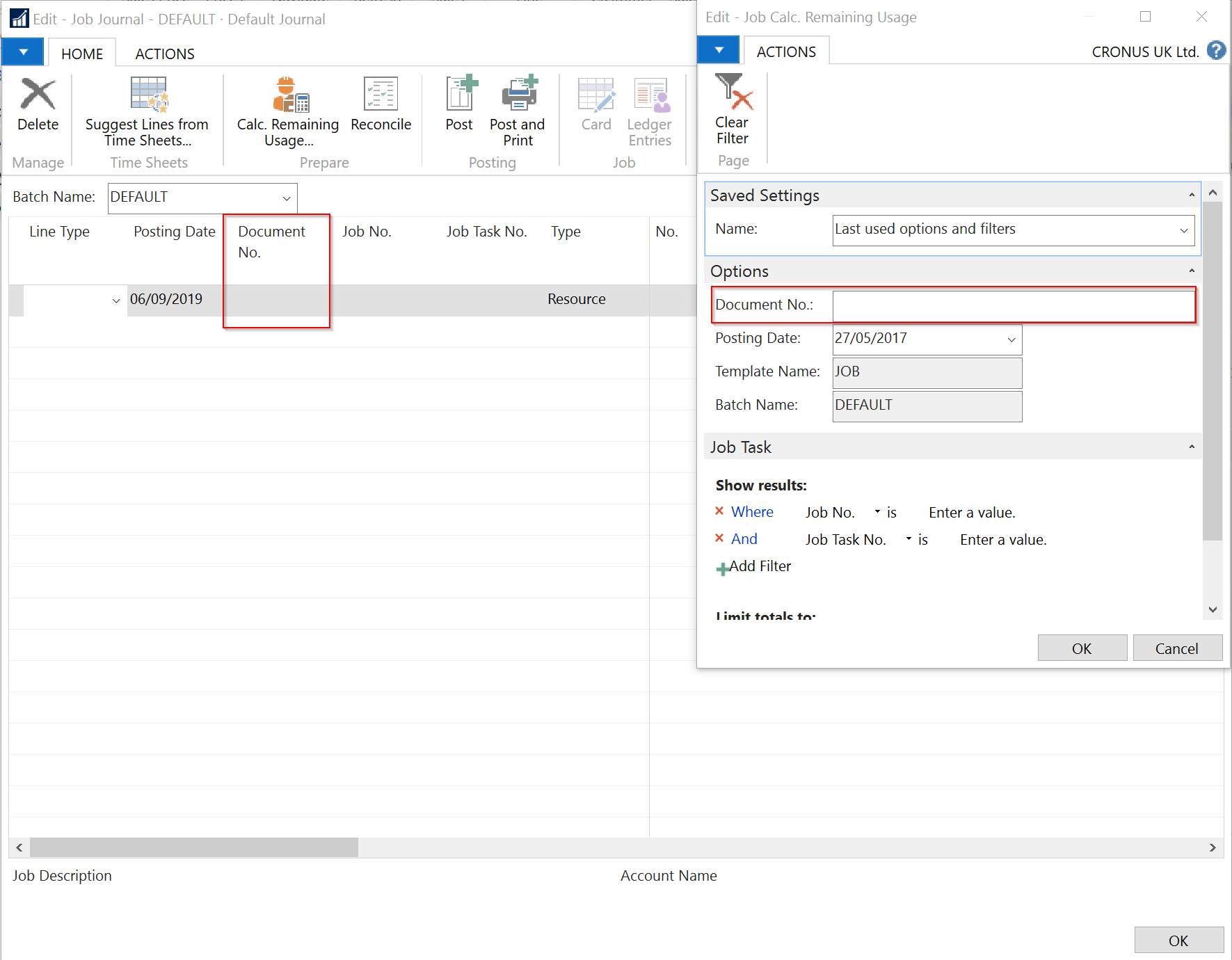

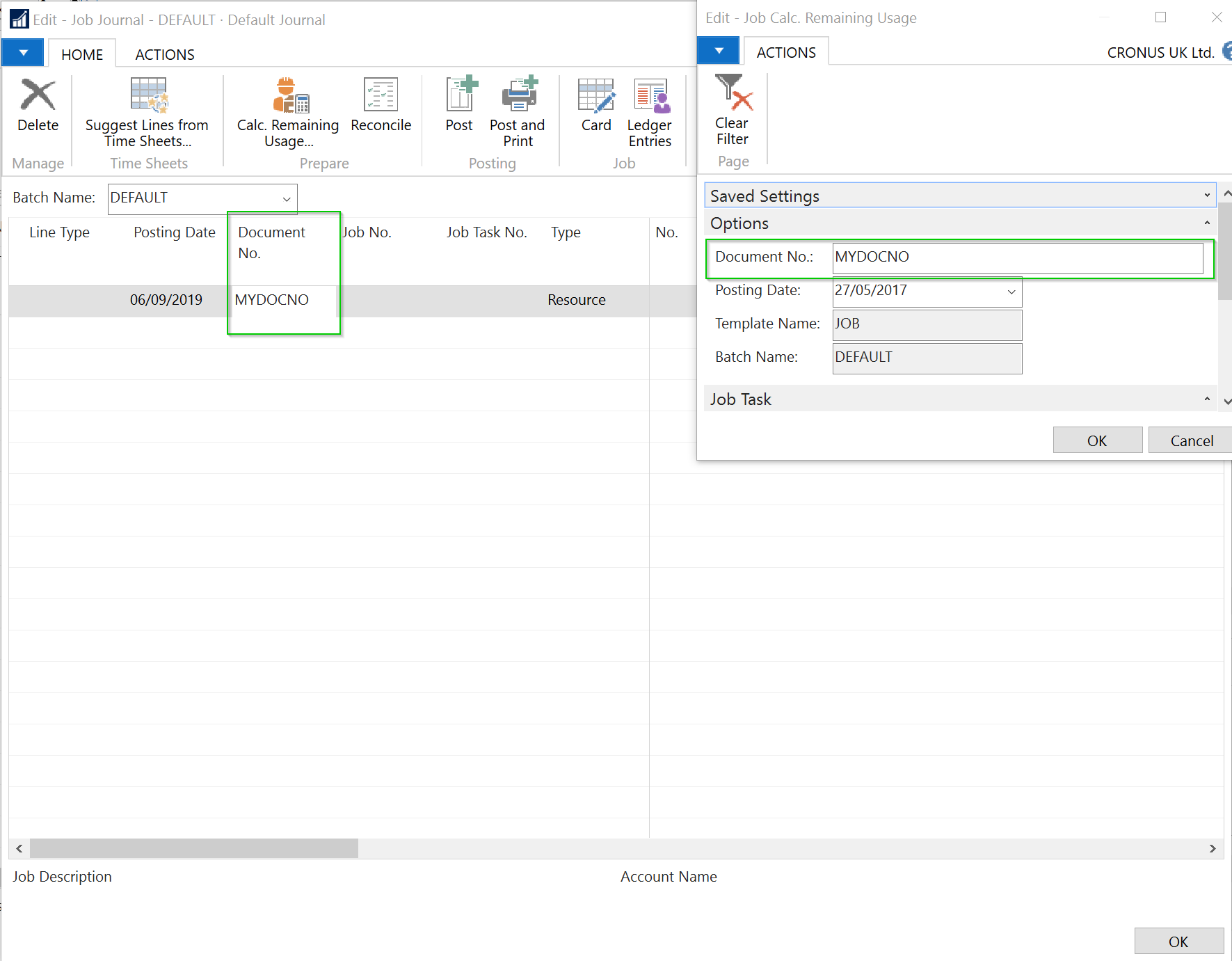

    • Nunzio Dugo
      May 27, 2017 at 12:38 PM
      Hi Michael
      The document no. is retreived from the line selected when the Job Calc. Remaining Usage is invoked. Ā Below are screenshots of two examples; one without a document no.and one with a document no. Ā As far as I am aware, when the user invokes the process, it simply copiesĀ the template name, batch name, and the document no. to the option fields.
