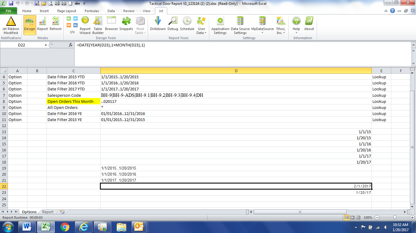

      Looking to see if there is a formula that will automatically populate the correct date range in the Open Orders This Month field on the filter below.  This filter needs to take the date the report runs and show the first day of the next month plus the lookback indicator “..”.  For example today is 1/20/2017 so that field should read “..020117”.  I found a formula that will automatically establish the “020117” but can’t figure out how to add the “..” in front of it.  You can see the fomula I’m using in the fx box.

      Hi Bob,
      Try the following:
      =NP(“DateFilter”,,[your formula])
      Rob

      Hi Bob,
      What Rob mentioned is the ideal solution, but I thought I’d add to the discussion an alternative as well, since with Jet Reports, there’s almost always a number of ways you can accomplish things — either using Excel functionality or the Jet functions.
      Excel Functionality
      The first day of the next month would essentially be:
      =DATE(YEAR(TODAY()),MONTH(TODAY())+1,1)
      And to add the “..” before it, you could very well do:
      =”..”&DATE(YEAR(TODAY()),MONTH(TODAY())+1,1)
      Now this will show you the Excel/Julian date (see screenshot below), which Jet understands just fine, so that technically does the trick:
      If you wanted it to be masked, you could also add the TEXT function to show mm/dd/yyyy:
      Bonus:
      If you set up your Accounting Periods as months, you could also do something like this instead:
      Finally, as Rob already mentioned, you could append the NP(“Datefilter”) and leave the first parameter blank to get an open-ended start date:
