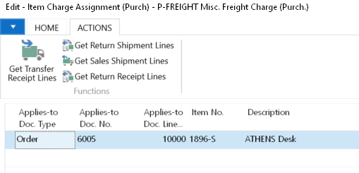

      A Transfer Order is created and the material is shipped on 2/26. The material arrives at its designated location on 3/2. In Nav, the shipment from the departing location is posted on 2/26 and the receipt at the destination is posted on 3/2. We receive a bill from the carrier with a date of 2/26 (when the material ships), so we will post the invoice on 2/26 in NAV.
      Item Charges must be tied to the posted transferĀ receipt, not the posted transferĀ shipment. This means that when we tie the item charge to the 3/2 transfer receipt and post the invoice on 2/26, the G/L recognizes the freight charge on 2/26 while the inventory subledger does not recognize the charge until 3/2. This causes our inventory subledger to be undervalued and not agree with the General Ledger balance as of 2/28 EOM.

      You know my (and many others’ on here) mantra — whenever possible I try to avoid customizations, but if the reporting workaround doesn’t work for you, ultimately you mightĀ want toĀ consider a customization of the Item Charge Assignment toĀ alsoĀ be able to pull in the Transfer Shipment:
      Currently it’s only “Transfer Receipts”, but if you had the option to attribute it to the “Transfer Shipment”, it seems this would resolve the issue you’re encountering.
      But this is just thinking out loud — you’d want a little bit of preliminary analysis and feasibility work done before going down this path.
