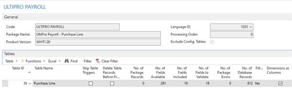

      1. Created a rapidstart name “ULTIPRO PAYROLL” on the Configuration Package area.. Rapidstart has only one table. Table 39 (Purchase Line). That is because we process payroll using an invoice. (Image 1 Configuration Package – Image 1.PNG file)
      2.- Created a Configuration Worksheet. setup is as follow: (IImage 2 Configuration Worksheet.PNG file)
      • Line Type: Table
      • Table DI: 39 (Purchase Line)
      • Assigned package ULTIPRO PAYROLL.Ā
      • Enable “Dimensions as columns”

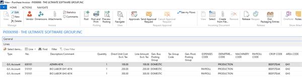

      10.- I finally go the Purchase Invoice and realized dimension information is missing. (Purchase Invoice.PNG file)
      I do have some information like EXPENSES CODE = Value PAYROLL but that information is coming from the G/L Account. If I check PAYROLL CODE dimension it has no values. It should be SALARY for this example.
