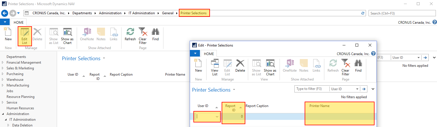

      I feel sorry you are experiencing this issue. Luckily, we have run into exactly the same issue a couple of months ago. Here is how it can be solved:
      – Navigate to “Printer Selections” page.
      – Click on the “Edit List” button in the ribbon.
      – Select the user who uses the print multiple invoices function, select the report ID (probably, “10074” in your case).
      – Select the printer to which you want to print multiple Sales Invoices.
      Close the page and start using the function. I hope this helps!

      Iaroslav,
      Thank you for this. Unfortunately this didn’t fix our issue as the issue is when we print to PDF not an actual printer.

    • Iaroslav Pankovskyi
      March 2, 2017 at 10:45 AM
      Andrea,
      Are you using a virtual PDF printer like Pr-mo PDF (there are lots of free software like this available)? If so, you can still select it as a printer on the Printer Selection page. That’s what I would do first thing. Second thing would be trying Ramin’s suggestion. Finally, if none of this works, you may need to contact your Microsoft Partner and/or submit the case to Mi-soft.
