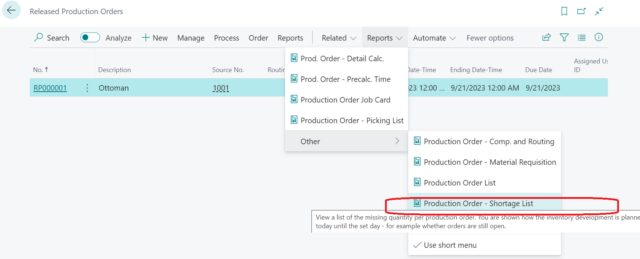

    Hello Blaine,
    There is a Shortage Report that you can run against your released production orders.

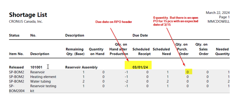

    Hi Lewis, thank you for the reply! A question about this report – when I run it, it is showing all zeroes for “Qty on Purch Orders” column. However, I know that we have Released P.O.s for the parts listed. I’ve run it on multiple production orders and each time I run the Shortage report, it is showing zeroes in that column even though parts are definitely ordered and in Released status on the P.O.s in question. Any ideas whether there is some setup issue here or other ideas why it would be showing zeroes in this column.

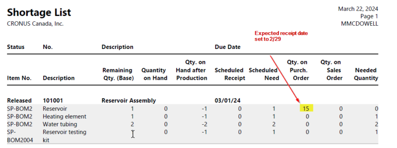

    Hi Blaine,
    Regarding the PO quantities on the shortage report – You need to pay attention to your dates on the production orders and the dates on the purchase order.
    If I put in a purchase order for a component required for manufacturing with an expected date of today (3/22), and create a production order for one of the components with a due date of 3/1 – the report won’t pick up the open PO quantity.
    If I go to my PO and update the expected receipt date onto my PO line to 2/29, the quantity displays on the report.
    The expected receipt date of the PO needs to be < the due date on the production order.
