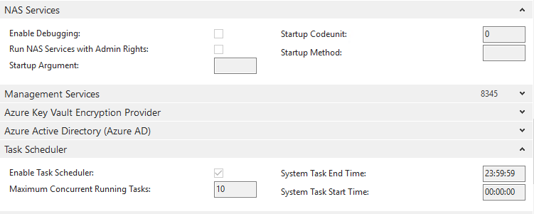

      I recommend you run Task Scheduler in its own Service Tier. This lets you restart it as necessary without affecting users.
      You also need to choose an account for the service to use that is an actual BC user with the appropriate roles and permissions. This is an important step.
      In the BC Admin tool, make sure everything on the NAS tab is blank. And also make sure Task Scheduler is enabled. See the image I attached.
      Once all of this is done, restart the service and then check the event log for any errors.
