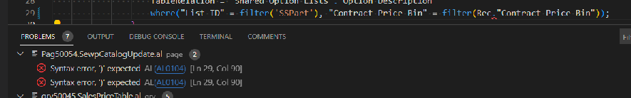

      but it only filters on the List ID field. I want to filter on two fields: “List ID” and “Contract Price Bin”
      If I hard code the value I want for Contract Price Bin, it works without issue:
      Ā  Ā  Ā  Ā  Ā  Ā  Ā  Ā  Ā  Ā  where(“List ID” = filter(‘SSPart’), “Contract Price Bin” = filter(‘abc123’));
      But I don’t want to hard code the value, I want to use the value of a field on the page. The page is populated by a record and has a populated field called “Contract Price Bin”.
      But when I try to use that, I get an error:
      Any Ideas how to make this work dynamicallly?

      Found the solution, thanks to a friend. Turns out my syntax was wrong. Instead of using the FILTER, I needed to use FIELD.
      The corrected line of code looks like this.
      Ā  Ā  Ā  Ā  Ā  Ā  Ā  Ā  Ā  Ā  where(“List ID” = filter(‘SSPart’), “Contract Price Bin” = field(“Contract Price Bin”));
