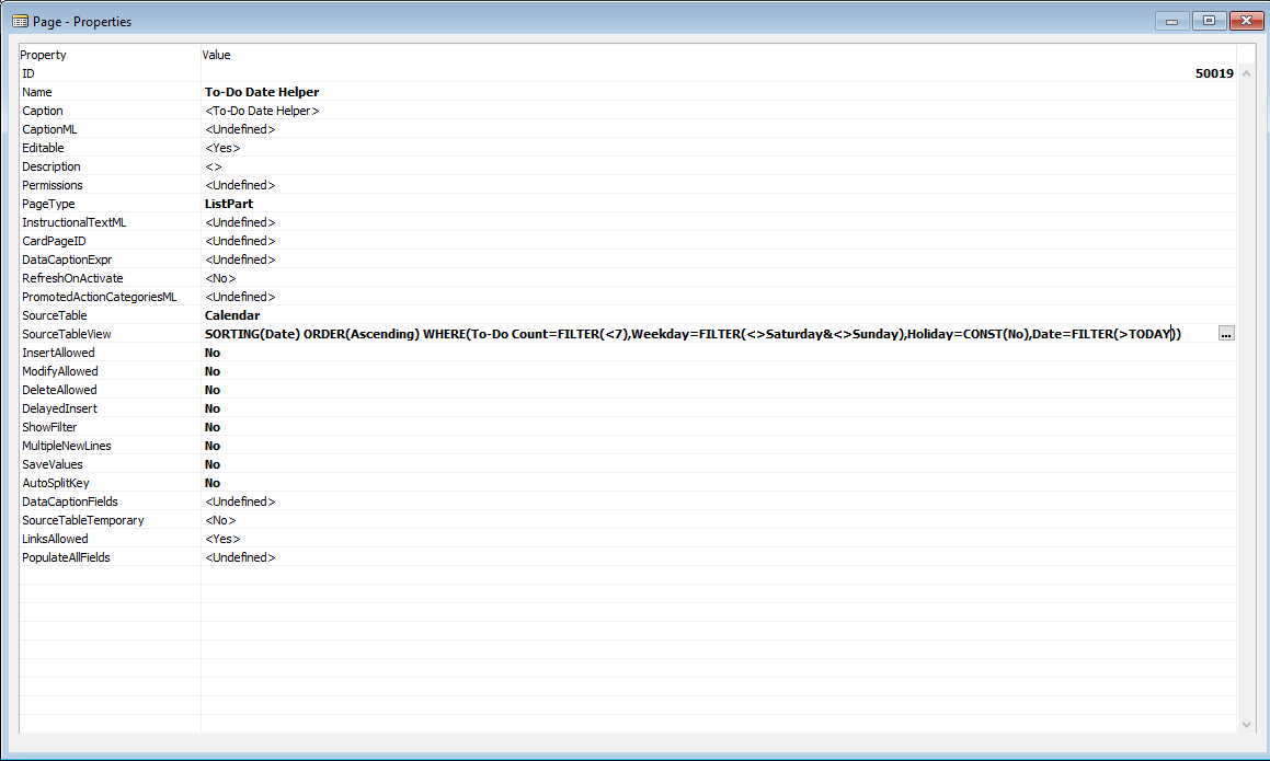

      The screenshot below is what I’m trying to use to capture “today”. It is the properties of a ListPart, which is a factbox that displays a list of dates given certain criteria as can be seen in the SOURCETABLEVIEW property. Essentially, this is a list that shows all of the future dates that don’t already have 7 or more to-do’s, that fall on workdays only. When I add this factbox to another page, it’s link is to the variable %USER so that it’s tailered to whoever is logged in. This helps us more evenly distribute our to-do’s as we create them.
      The functionality I’m trying to accomplish with >TODAY is to only show dates in the future.
      Rick, if I try your suggestions of TODAY and WORKDATE, just like ‘t’, those are simply evaluated upon compiling and are then hardcoded to 2/27/2018, which it stays at.

    • Franz Kalchmair
      February 27, 2018 at 2:00 PM
      ok, that’s different.
      best you make that in the page’s onopenpage by code via setrange/setfilter.

    • Jason Luchka
      February 28, 2018 at 7:46 AM
      ?We have similar custom activity cues in our role centers. We use Date Filter Flowfilters and code in OnOpenPage (for the activity cue) that passes dates into a table function (the activity cue table) to populate the Date Filter. It works like a charm.
