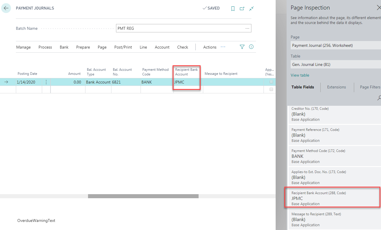

      Zoom on the payment journal line with Ctrl-Alt-F1 and verify that the field Recipient Bank Account has a value.

      I opened the Page Inspector on the Payment Journal and indeed the Recipient Bank Account is filled in. “JPMC” is the code for JP Morgan Chase, which is this vendor’s bank. “JPMC” is filled in. Please see screenshot below.Ā
