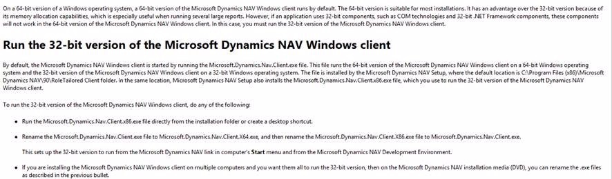

      Just wanted to give an update on this. Was guided towards a direction that the solution was NAV architecture versions between 32-bit and 64-bit.
      Desktop ran 64-bit and NAV 64-bit and for the external components to work, had to get NAV to run in 32-bit. Followed the steps from the link below and now works with our USB scale.

    • Jim Augenstein
      January 26, 2017 at 10:34 AM
      I have to make a correction. My typing mistake yesterday. I’m sorry for that.
      You must be using the 32 bit (x86) NAV client not the 64.
