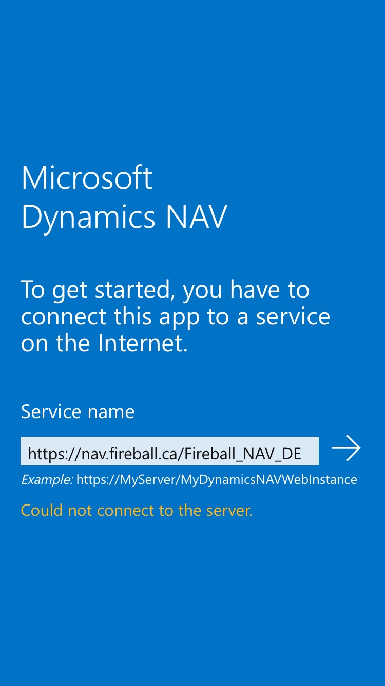

      However, we are having issues gaining access to the environment through the Dynamics NAV universal app for IOS.
      We cant seem to get past the ‘Service Name’ screen where the external address of the server is inputted as we get the generic ‘Could not connect to the server’ error.
      Using a packet trace through our Fortinet Firewall seems to indicate our WAP may not be re-directing some .ASP pages incorrectly, as indicated from the snippet below.
      These pages exist on the NAV server but for whatever reason the request isnt getting forwarded and its looking for these pages on the WAP.

      So, as a general question, what could I be missing in terms of setup if the access to the web client works on any device except within the IOS Dynamics Universal NAV app?
      I should mention I have also tried creating an Azure install under a trial just to demo the app, and have even install the self-signed cert for the NAV server ion Azure on the device using the universal app itself and still cannot connect to our NAV installation (Trust Root CA is enabled on the IOS device).
