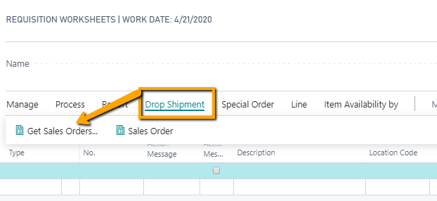

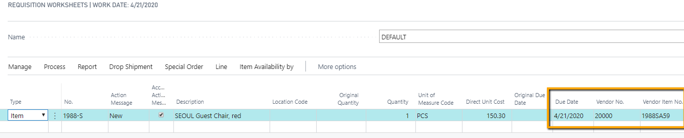

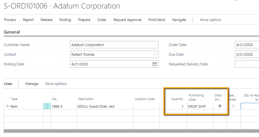

      You don’t need a customization. You can use the Requisition Worksheet to get information from your Sales Order Lines indicated as Drop Ship. Then carry out the action plan to create Purchase orders for the drop shipments.
      On the sales order, indicate the items to dropship. Make certain your Purchase Code is setup for Drop Ship.
      SOGo to the Requisition Worksheet and select Drop Shipment, Get Sales Orders
      Req Wksht
      DS line

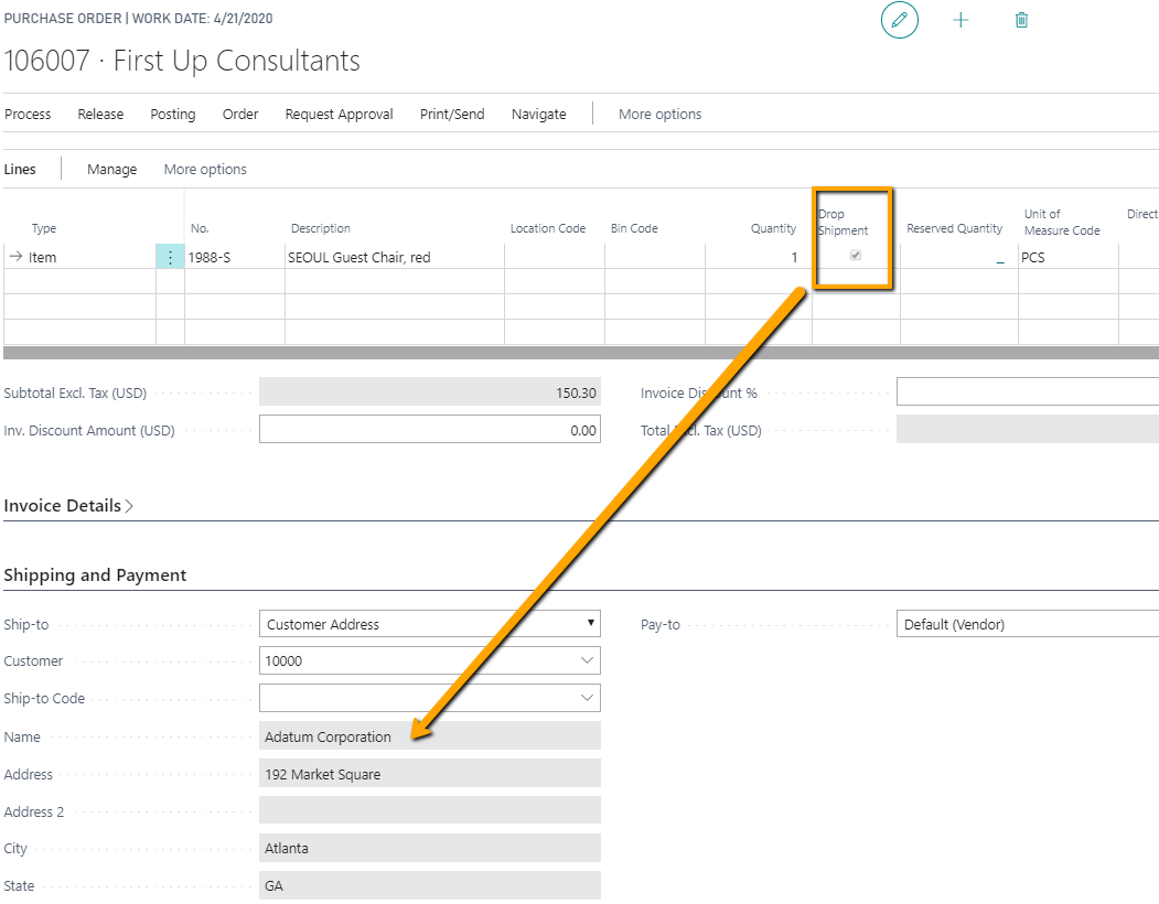

      If you have a vendor assigned to the item and this vendor is correct, all you need to do is select Process, Carry Out Action Message and your purchase order is created for the drop shipment.
      PO
      Let me know if this may be what you saw previously, or if not, if it could work for you.

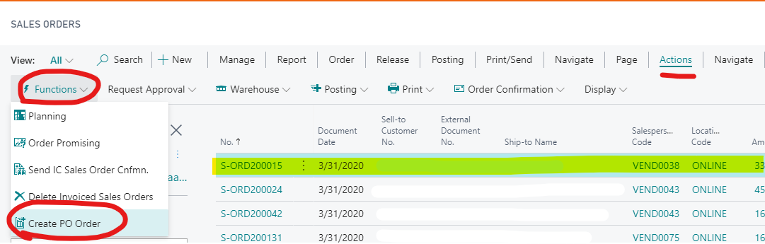

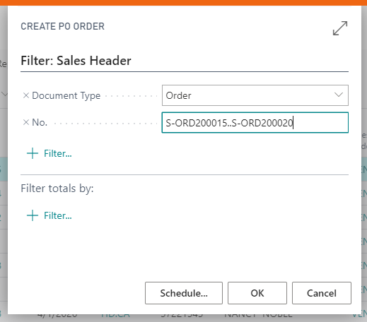

      Another method to create a PO from dropship SO:
      Highlight the sales order and goto Actions–>Functions–>Create PO
      If you want to create multiple PO at the same time, select the first sales order and use the same process and enter the series.Ā
      This only works if all your sales orders are numbered consecutively in this case from 15 to 20.

      Thanks for the detailed replies with screenshots!Ā  Unfortunately creating the PO with the SO highlighted doesn’t work if it’s a dropship transaction.Ā  And I was hoping to be able to initiate the PO creation with a button on the SO screen instead of using the Req Worksheet or navigating to the New PO screen.Ā  I do appreciate the replies, though, so thank you!
