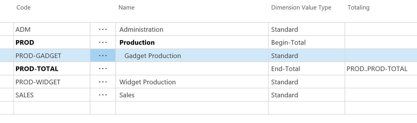

      The only other thing I would add is if you want to total your dimension values, and your words don’t sort correctly alphabetically.
      In other words, if you have several dimension values and you want to be able to sub-total them, like this:
      Unsorted Dimensions
      Because of the alphabetical order of those values, PROD-WIDGET is outside of the totaling.

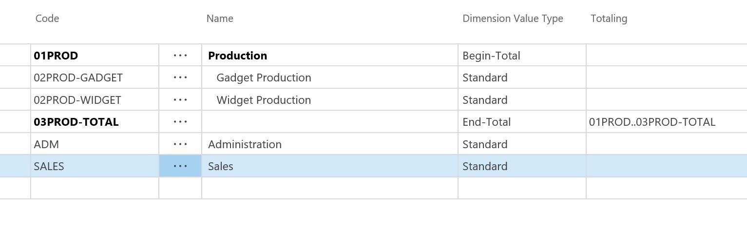

      But if I use a numeric prefix, I can fix it easily, as in this image:
      Sorted Dimensions
