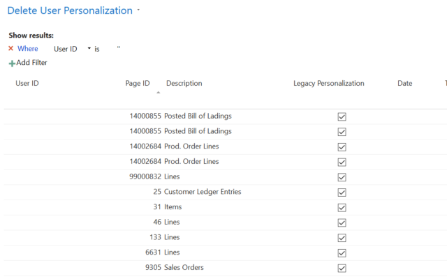

    This shows the list of users and their personalized pages. To clear a user’s personalization, click the relevant row, or choose Manage, and then choose Delete.
      April 28, 2023 at 11:35 am
      Yes, thank you Linda. I am aware of that. It the example I provided, however, there are no user IDs associated with the rows.

    That’s interesting. I just checked in my BC21 environment and don’t have blank entries like that.
  • David Wiser
    May 2, 2023 at 2:02 pm
    Like Chris, I also do not have any blank user IDs. If the personalization was done for the role, it is captured in the “Customized Pages” page. Did you recently remove a user? If so, they may have had personalized pages. Also, I noted that all your examples had “Legacy Personalization” checked. This usually means the personalization was made in an earlier version of NAV.

    I have this same issue, (BC14). User ID is blank but on some the User SID is there. on others, it’s just a dummy user sid. like the user was deleted.
    July 27, 2023 at 1:08 am
    Just a follow up on this thread: I was informed that these are orphaned records and they are safe to delete. This situation could have been created in older versions of NAV if a user was deleted but the user’s personalizations were not deleted.
