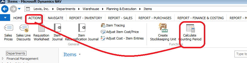

      February 28, 2017 at 8:56 AM
      Are you running the “Calculate Counting Period” action on the Item (or Stockkeeping Unit) card?
      NAVUG Programming Committee
      NAVUG Membership Committee
      March 2, 2017 at 9:46 AM
      From the Item List or the Item Card, check the ACTIONS tab and you should find “Calculate Counting Period”.  This will update the next counting period for an item based on the Physical Inventory Counting Period Code.
      From the Item List on the Actions tab:
      From the Item Card o n the actions tab:
