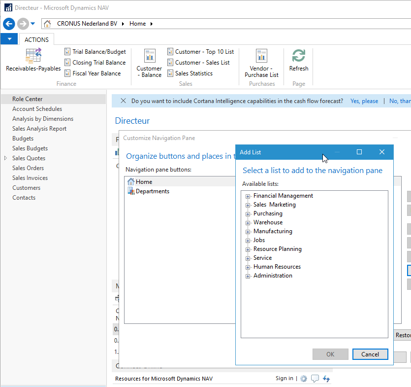

      When we try to customize the navigation pane, we have noticed that not all options from the Departments menu seem to be available. For example, if we go to Departments>Inventory, there are quite a few choices. However if we go to customize the Navigation pane, the choices we have for Inventory are limited.Ā
      I attached a screen shot of what we see. This is from an admin user with super permissions so I don’t think it is a user permission set. It is the same on different user roles too.
      Has anyone noticed this before? I am trying to add some of the ones shown in the Departments menu into other sections of the navigation pane but they don’t seem to be an available choice. Any advice would be appreciated.

      Jeffrey,Ā
      Which version are you using?
      Below a print-screen of 2017 (NL localization).
      As you can see I don’t have an Inventory menu at all.Ā
      Looking at you menu, I can see you have customizations (add-ons?)Ā

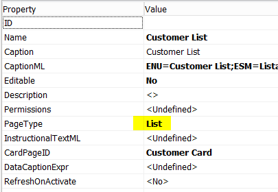

      I believe it is a combination between the Page Type (Card,List,Document etc…) of a Page Object
      and the Department assigned to the object in the Menusuite:
      But unfortunately I have never seen documentation on this so I can’t say for sure.Ā  I would love for someone to document this.

      Note that you can only add to the navigation pane pages of type list.

      Youssef is bang-on with this one — only list pages can be added to the Navigation Pane. A little brief blog post below goes into the general overview of this:

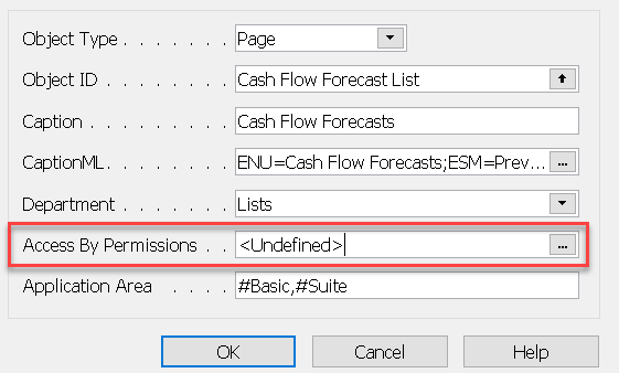

      Additionally, you won’t see lists in that Department tree if there’s an “Access by Permission” attribute set to that MenuSuite item (see below):
      This is a very cool way that you can set up inherited hide/show logic that depends on whether a user has any of the RIMD permissions on other objects.
