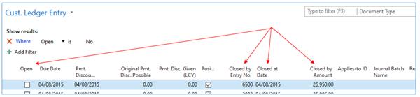

    • Leo Chen
      October 15, 2019 at 12:58 AM
      Hi Julia – do you have access to Object Designer or using Jet Report?
      There are fields in Cust. Ledger Entrty (Table 21) that tell you how Invoices payment applied, or if invoice is still open, partially paid, etc.Ā Ā
