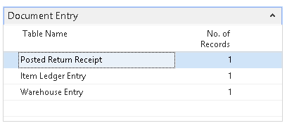

    • Ian Ray
      June 23, 2017 at 11:52 AM
      Not creating an item ledger entry is odd.
      If you do “navigate” from the posted return receipt, you don’t also see an item ledger entry and warehouse entry?
      This is what I see with “return receipt on credit memo” checked.

    • Michael Carr
      June 23, 2017 at 2:42 PM
      Ian and David
      Thanks for the sharing of info.
      I didn’t realized that it creates a return no matter what and thus there is no way to just give a customer money back and leave them a trail of what you are giving them credit for items that are disposed of on site or just disposed of after testing. No reason for these to impact inventory and in fact , they technically are your customers property until you issue credit so to post to inventory. So that doesn’t meet US accounting principles.
      Not customer oriented handling at all, not very thoughtfully designed for sure.
