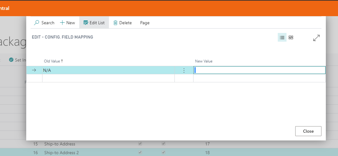

      I’m trying to use configuration packages field mappings to modify the data we receive and insert sales orders into dynamics and I have 2 issues that I hope somebody can help me resolve.
      Issue 1:
      We receive “address 2” field for orders and sometimes there is a valid value and other times its “N/A”.
      So rather than manipulating data I have tried to set up a field mapping old value–> new value to skip when the field is “N/A”
      My issue is when I leave the “New value” as a blank I get an error on upload, so I have to enter a space.Ā  Is there a known workaround so the configuration package skips the field “address 2” when it sees the value “N/A”?

    • Kevin Fons
      April 21, 2020 at 7:56 AM
      For the first one the new value needs to be a space and not just nothing and it will replace with a blank value.
