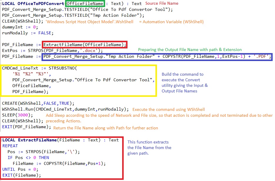

      Converting Office Files into PDF from Navision
      KSD Consultancy remove preview
      Today in this post i will walkthrough how we can convert any MS Office File into PDF. It have been many time required to convert any attached file with the record in Navision to PDF format. To perform this action we will require a tool which can be downloaded from: OfficeToPDF download link :- http://officetopdf.codeplex.com/releases/view/118190
      View this on KSD Consultancy >
