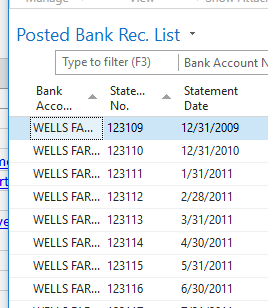

    • Ron Ketterling
      February 19, 2018 at 6:02 PM
      The Bank Reconciliation will appear here if you are using the traditional NAV reconciliation model as shown below.Ā  If you are using the new model, it may appear in Statements – see the Navigation pane below.Ā  Your partner may have done some modifications that do something different than stock NAV.Ā  Your partner should be able to tell you how to get this data.
      You can check in Developer on table Posted Bank Rec. List (10129) and new model table Account Statement (275). Ā
      Hope that help.
      Ron Ketterling
      President
      Minneapolis MN
