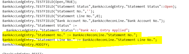

      If you want to retain that link, you’d need a customization to modify the Bank / Cheque Ledger Entry to have a custom “Statement Value Date” field, Ć  la the following existing fields that get populated when it gets processed in the Bank Rec.:
      And then modify any function where that’s set, such as the SetReconNo function in Codeunit #375 (Bank Acc. Entry Set Recon.-No.):
