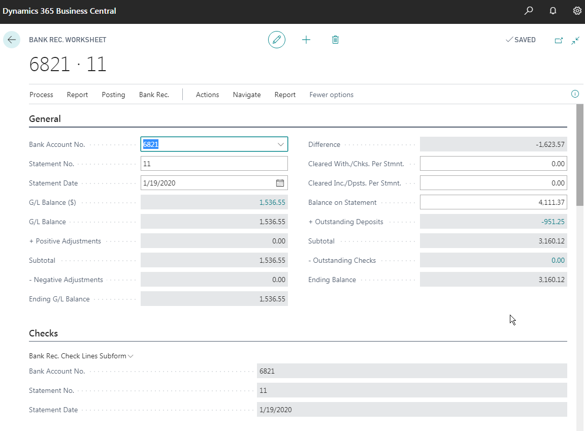

      How do I enable reconciling bank accounts using the Bank Rec Worksheet? I have the Bank Rec. Worksheet available for my production company. I would like my customer to do bank recs using the worksheet, instead of the standard Bank Account Reconciliation. Below is the heading of the Bank Rec Worksheet.

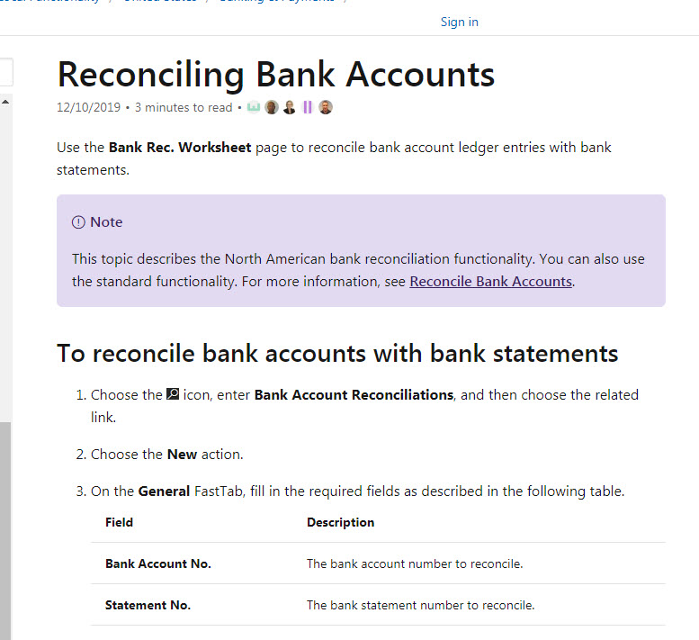

      Thanks for replying. In the BC Documentation it is described as the “North American” way to reconcile a bank account. Additionally, Microsoft recommends the standard functionality, which is what you see.Ā https://docs.microsoft.com/en-us/dynamics365/business-central/localfunctionality/unitedstates/how-to-reconcile-bank-accounts

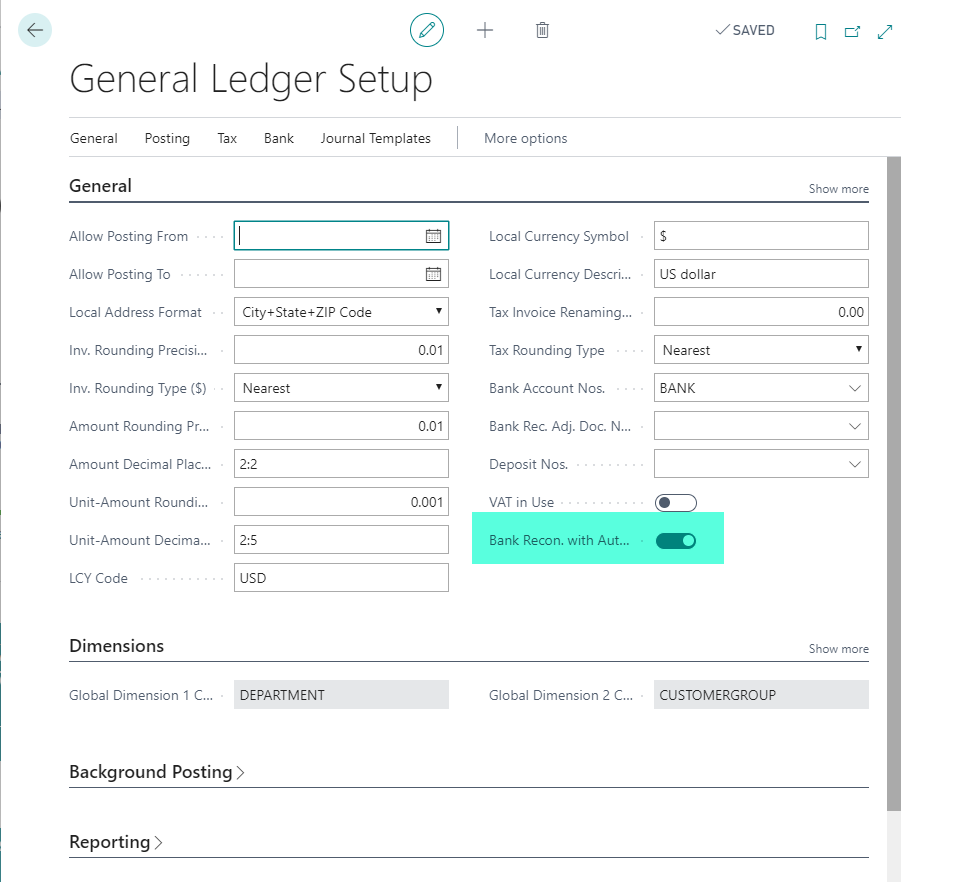

      Check the General Ledger Setup and ensure the Bank Recon with Auto Match setting is turned off.Ā  This setting is per company so if you have more than 1 company setup you’ll want to make sure you update it in all companies.
      John Hawkins
      Oilfield Software Solutions, LLC
    • Steve Simon
      January 24, 2020 at 12:06 PM
      John,
      That was it ! Un-checking Auto Match in GL Setup for the company will show the Bank Rec Worksheet for any new Reconciliation. Thank you so much. Our client is now able to reconcile his bank accounts and save the posted reconciliation file, so as to have an audit trail.
